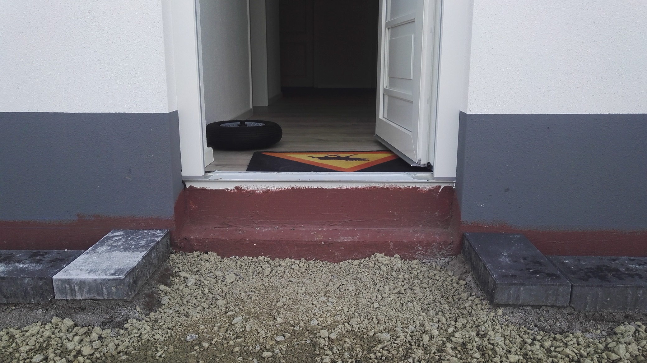

Hi,
I am now considering how to design the exit at the patio door.
At first, I thought of a block step. But due to the given shape, several cuts would be necessary to make it fit. I don’t have the machine for that, and ordering one would be rather expensive for me.
Nevertheless, I will get some quotes again.
Therefore, I am leaning towards simply making the platform out of four slabs (front, two sides, cover).
So far, I have found that two variants are common for this:
1) Create a concrete base and glue the slabs with frost-proof "tile adhesive"
2) Set the slabs individually like curbstones/lawn edging stones in concrete, fill the interior with gravel, sand, or lean concrete, and place the cover on top
Regarding 1), I know of some (older) projects (from the rental era) where the glued slabs fall off after many years of repeated "stepping/driving on them" (by all residents).
Regarding 2), how exactly do I fix the cover properly? Just placing it on top or simply "gluing" it to the standing slabs does not seem durable to me. Possibly then fill the interior with lean concrete and directly fasten the slab with it?
a)
Can you add anything about both variants? Advantages and disadvantages? Is any of this nonsense? Are there other variants (apart from a whole block step)?
Additional questions:
I have not researched this intensively yet, but maybe someone can answer briefly alongside:
b) How are the slabs "jointed" at the points where they touch each other (there should be no visible joint)? Simply outdoor silicone?
c) How is the connection to the house wall or the door "jointed"? Also silicone?
If more info is needed, just ask.
