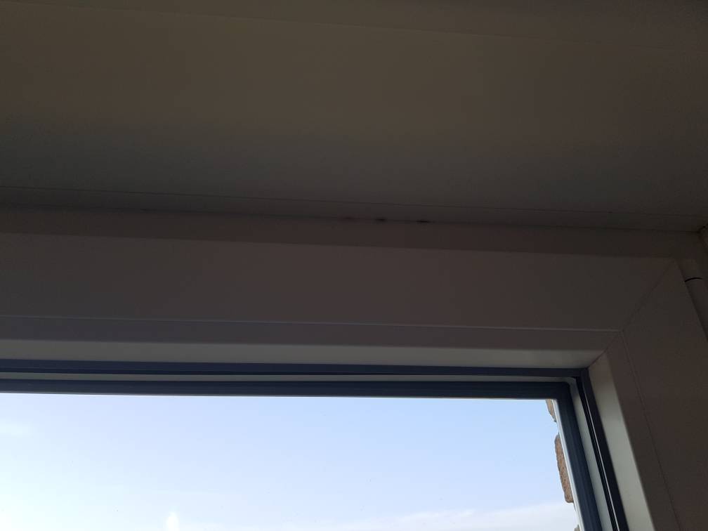

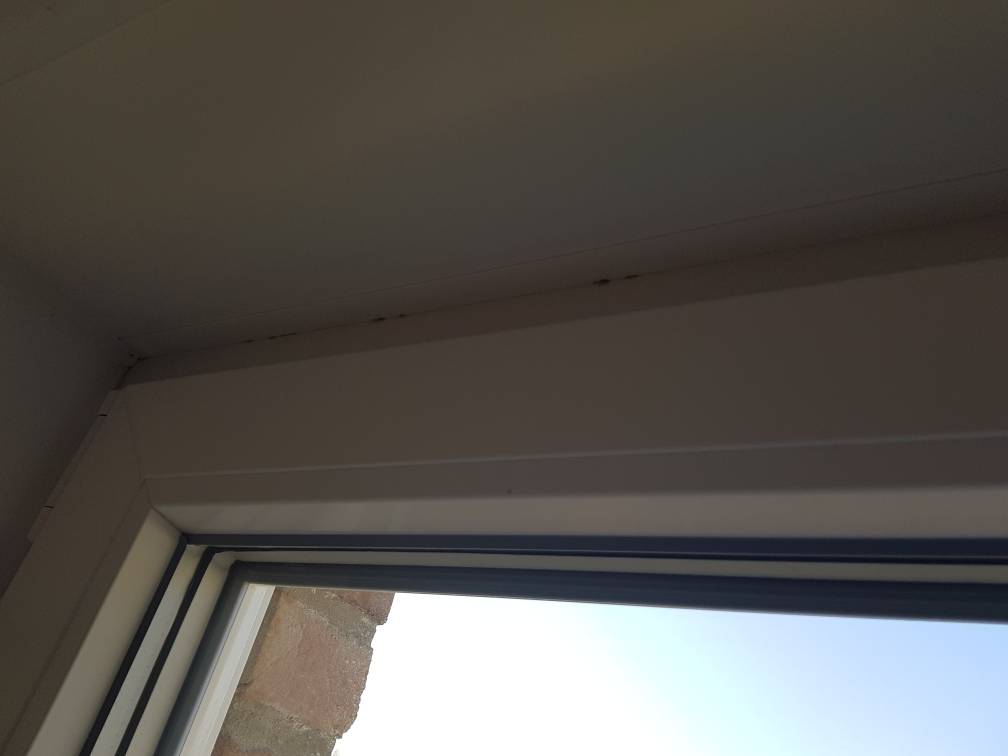

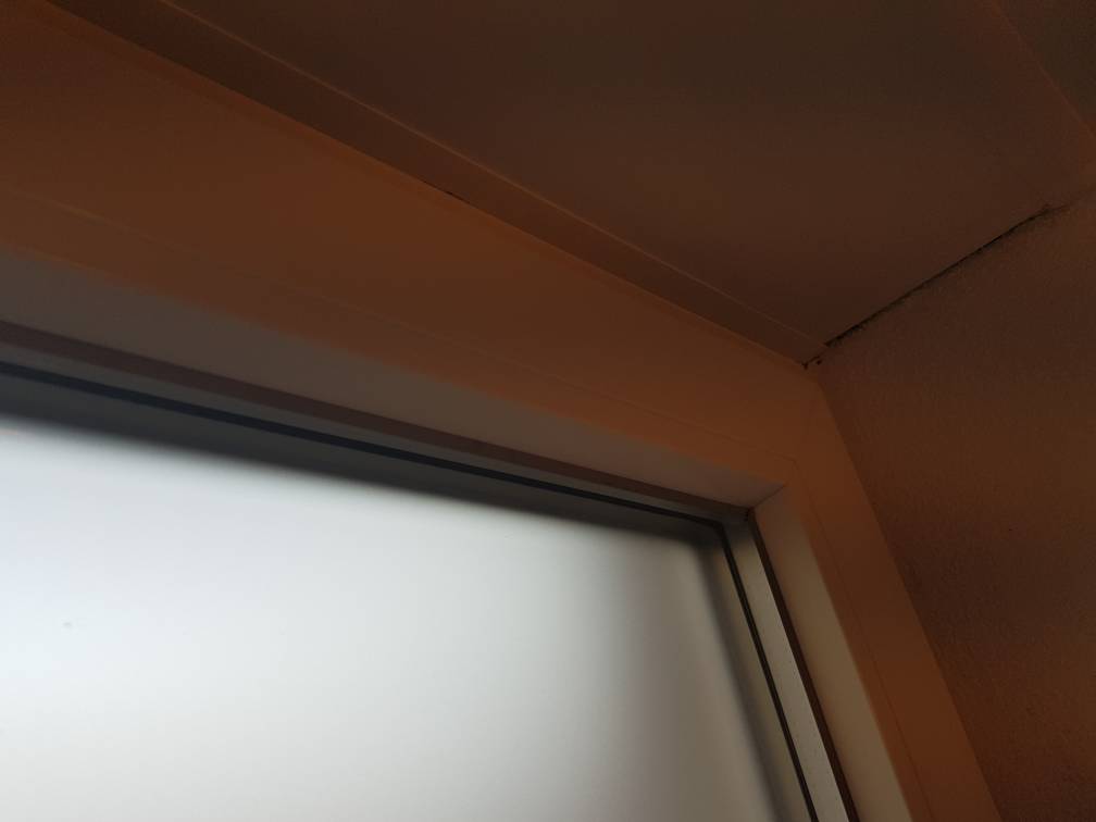

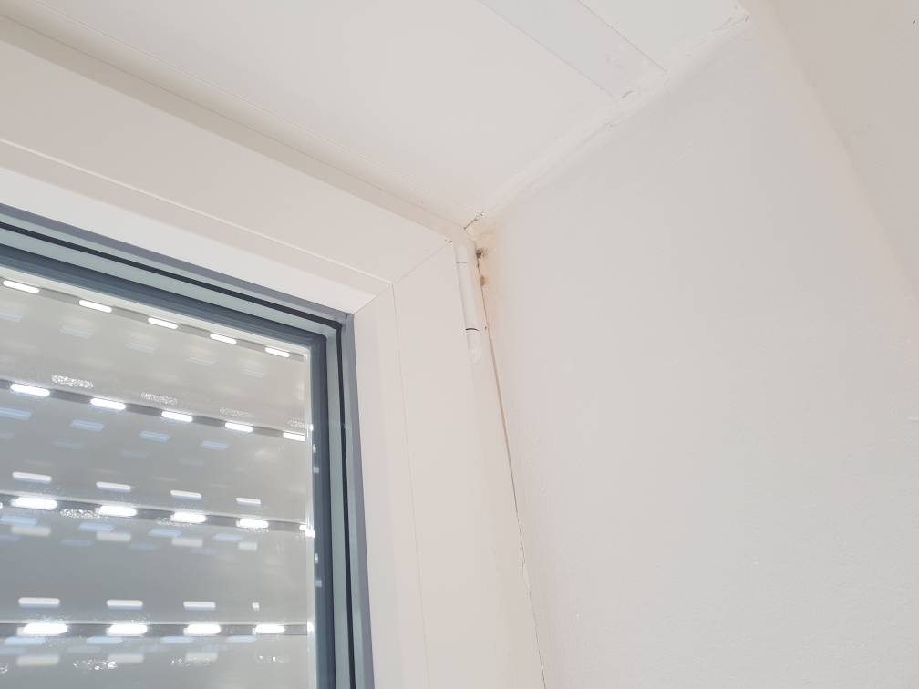

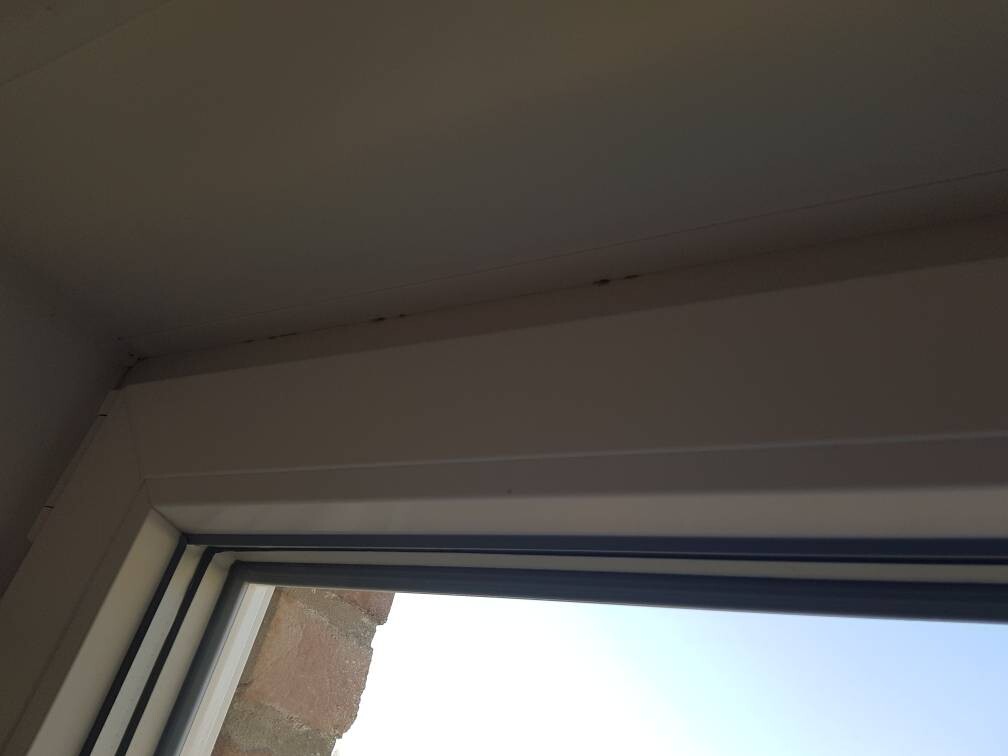

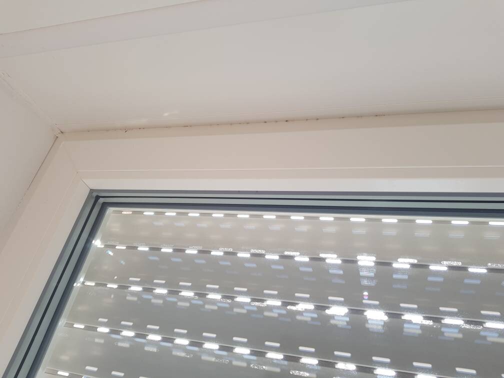

I saw the following on the roller shutter box of 3 windows yesterday. Is this mold?
FundS
2018-02-18 13:11:29
  • #2
It is hard to see in the photos. But it almost looks like mold.
apokolok
2018-02-19 13:50:11
  • #3
Looks like it. Cold, uninsulated roller shutter box --> warm air condenses on it --> mold. Since it is very small area and with a logical and easy to fix cause, I would say it is not further tragic.
Malz1902
2018-02-19 14:34:14
  • #4
Roller shutter boxes are insulated/[gedämmt]
Lumpi_LE
2018-02-19 14:45:41
  • #5
Then they are poorly insulated or not professionally installed, in the 3rd picture you can clearly see the mold and condensation damage. Always provided that ventilation is done correctly.
Malz1902
2018-02-19 14:51:34
  • #6
Our site manager will come by tomorrow and take a close look at it.
