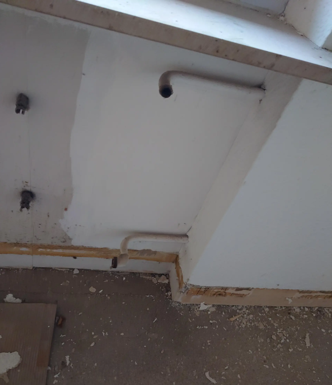

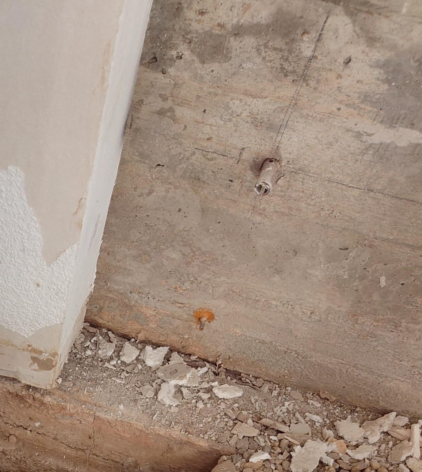

Hello everyone,
I am renovating a house from the 70s, it has 24 cm calcium silicate brick masonry (construction 11 cm calcium silicate - 2 cm air - 11 cm calcium silicate). From the inside there are then 2 cm of Styrofoam and everywhere covered with drywall.
The radiators are being replaced by underfloor heating, the niches are to be insulated. Now there is a row of calcium silicate bricks and then Styrofoam/drywall installed.
This is how it looks before removing the drywall (unfortunately no better picture available):
This is how it looks when removing the drywall (unfortunately no better picture available):
Which materials are best to use for insulating and closing?
Build Ytong (aerated concrete) slightly staggered into the niche and then later attach a cut-to-size gypsum board. Then fill it all and it will look seamless?
Thanks a lot and best regards

  • #2
Insulation is actually done with insulation materials - EPS, PUR, mineral wool, etc. You don’t insulate with masonry or so little that you hardly notice it. You can simply use Ytong, build out the niche with it, and then plaster it. If you absolutely prefer drywall, that is also possible - just be careful not to create any offsets.

  • #3
Thank you for your feedback, what is better thermally? Fill everything with Ytong or in the niche Ytong -> Styropur & then GK

  • #4
Insulation is always better. But then please seal everything airtight so that no warm (moist) air can reach the inside of the exterior masonry. Otherwise, it will condense there. I would only use Ytong and eventually equip the exterior walls with an ETICS or similar. 1/3 sqm with a few cm of Styropur doesn't really help.
