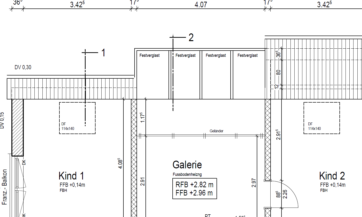

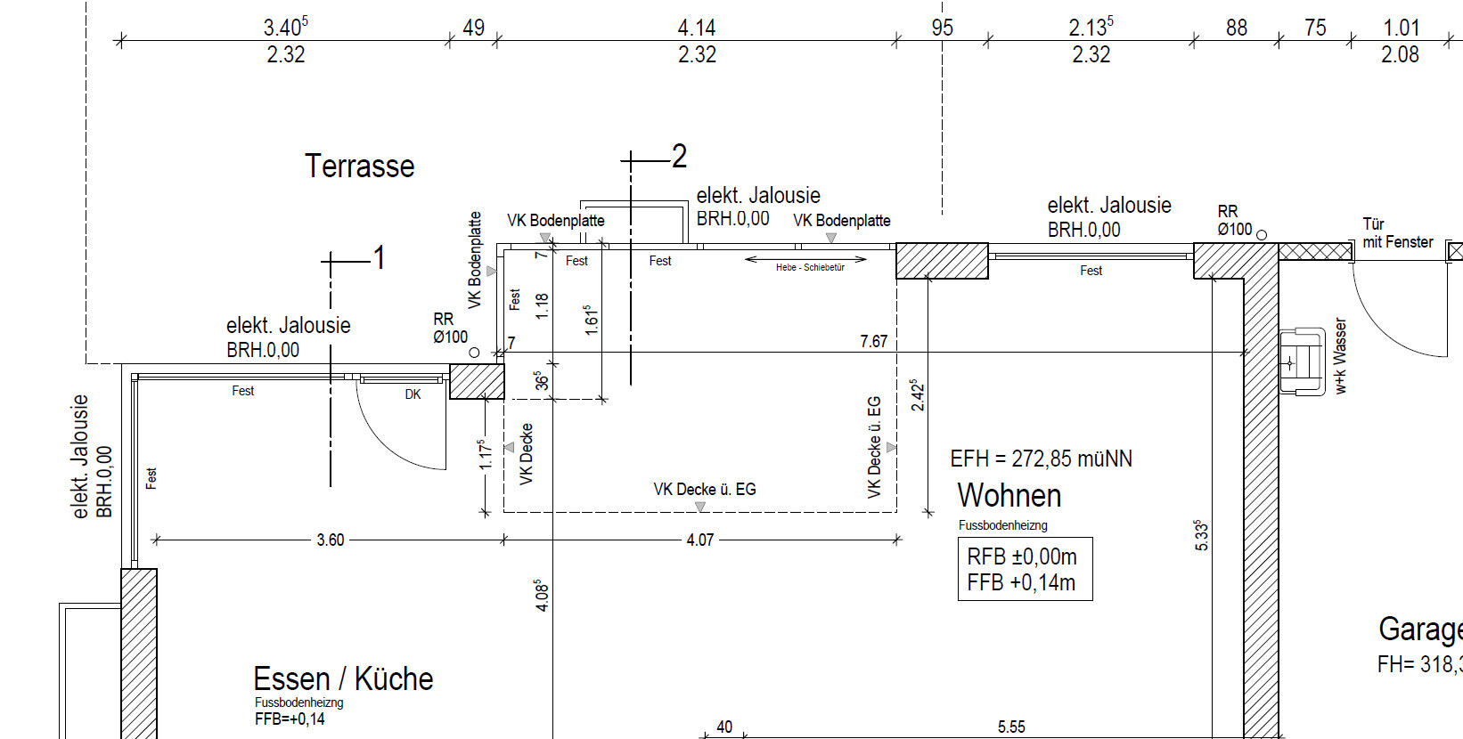

Hello everyone,
we will be installing a conservatory integrated into the living room with substantial roof glazing. Now, a conservatory builder mentioned that a convector heater in front of the panes would be necessary because the underfloor heating is not sufficient. The conservatory will have triple glazing.
Has anyone installed something similar and can share from experience what is really needed? I would like to avoid the convector heater if possible, as it is ugly and disturbing... even if recessed into the floor.
Thanks + regards

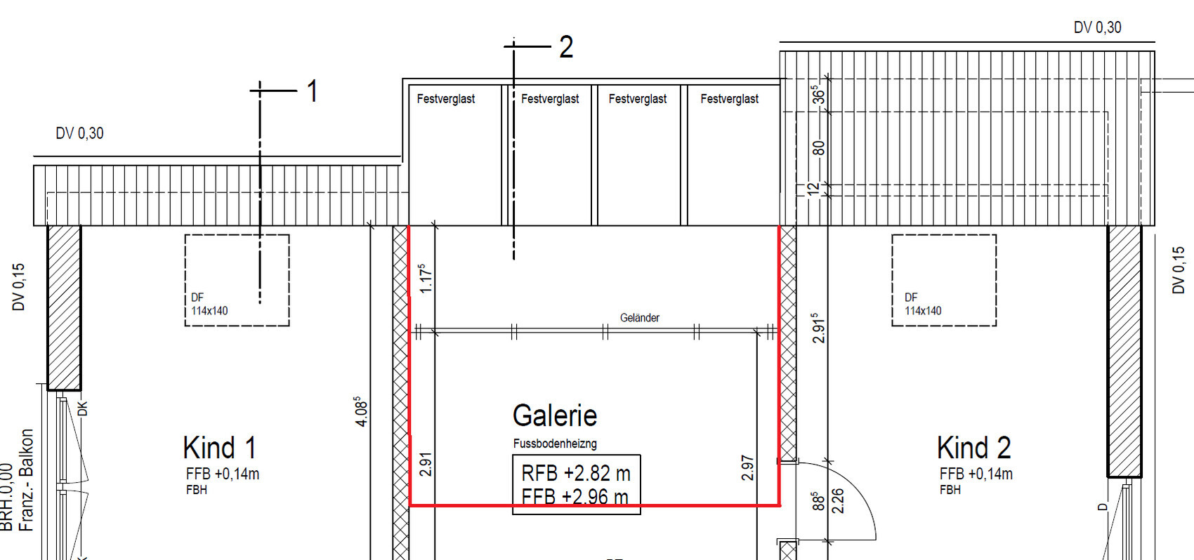

merlin83
2016-03-05 09:26:20
  • #4
EG:
OG:
The area marked in red shows how far the glazing is extended upwards.

BTW & OT: 14cm floor construction is very tight - hope your plumber and electrician coordinate well.

I suspect our electrical cables are embedded in the ceilings.
