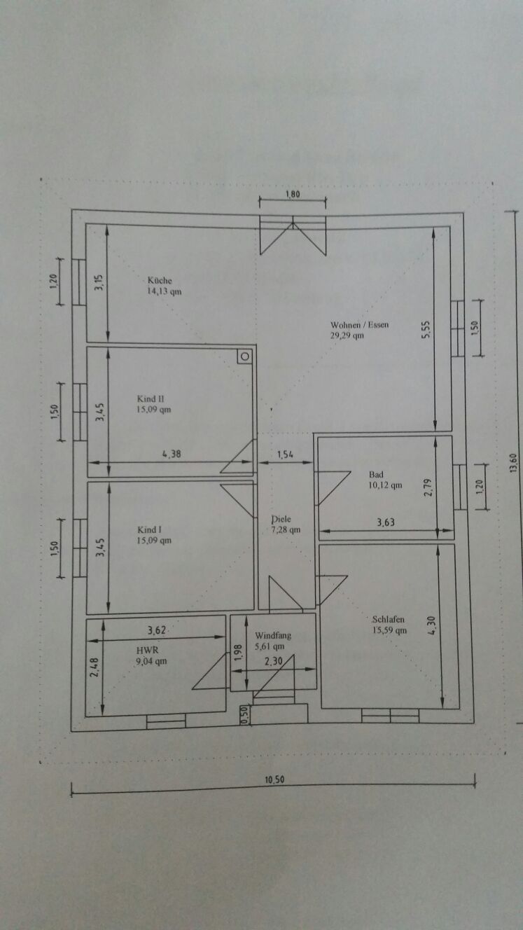

Hello dear people,
I would appreciate criticism and advice regarding our floor plan. We want to submit a building application this year.
Thank you very much in advance...

A bit little space in the entrance area for a wardrobe intended for 4 people (plus guests).

Zoning = 0

What exactly is meant by zoning?

That you lead all guests past all the bedrooms.

The floor plan looks as if all the rooms were simply arranged one after the other.
Zoning would mean, for example, that especially in a bungalow a separation between private and public spaces is created. So far, every guest has to walk past the bedrooms. There is no privacy like that. :-(
Please upload a site plan so that the position of the rooms in relation to the property can be assessed.
