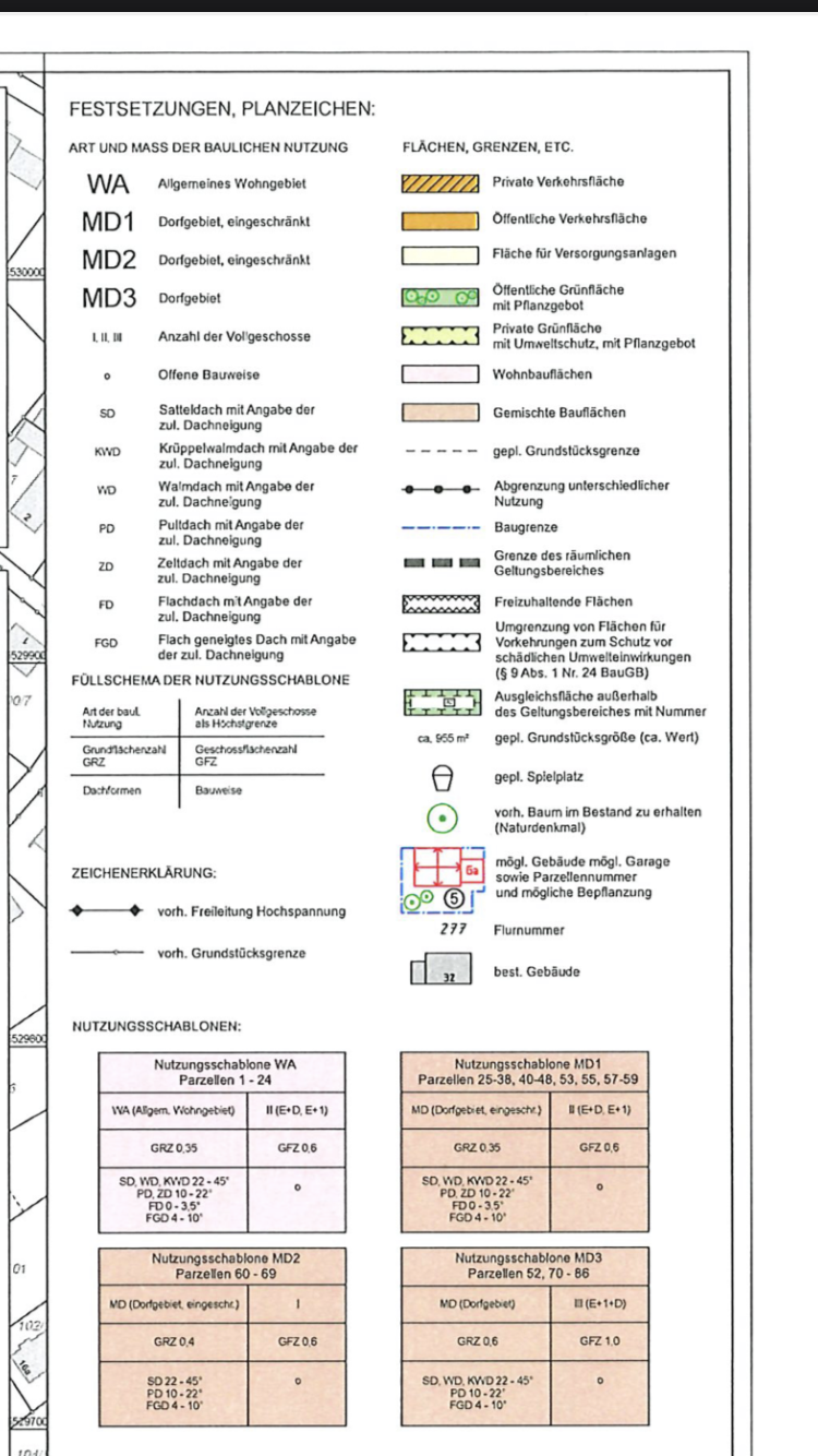

Then treat us to some pictures of the property, site plan, development plan.
Michlhausbauaa
2020-11-02 16:38:37
  • #3
see attached - development plan "free" floor space index 0.3

without a development plan, but then a floor area ratio of 0.3 does not really fit together. Unfortunately, you can't really see much from such a mini excerpt, which is also crossed out in red
2020-11-02 16:54:14
  • #5
Certainly not: where there is a "planned street," there is also a development plan.

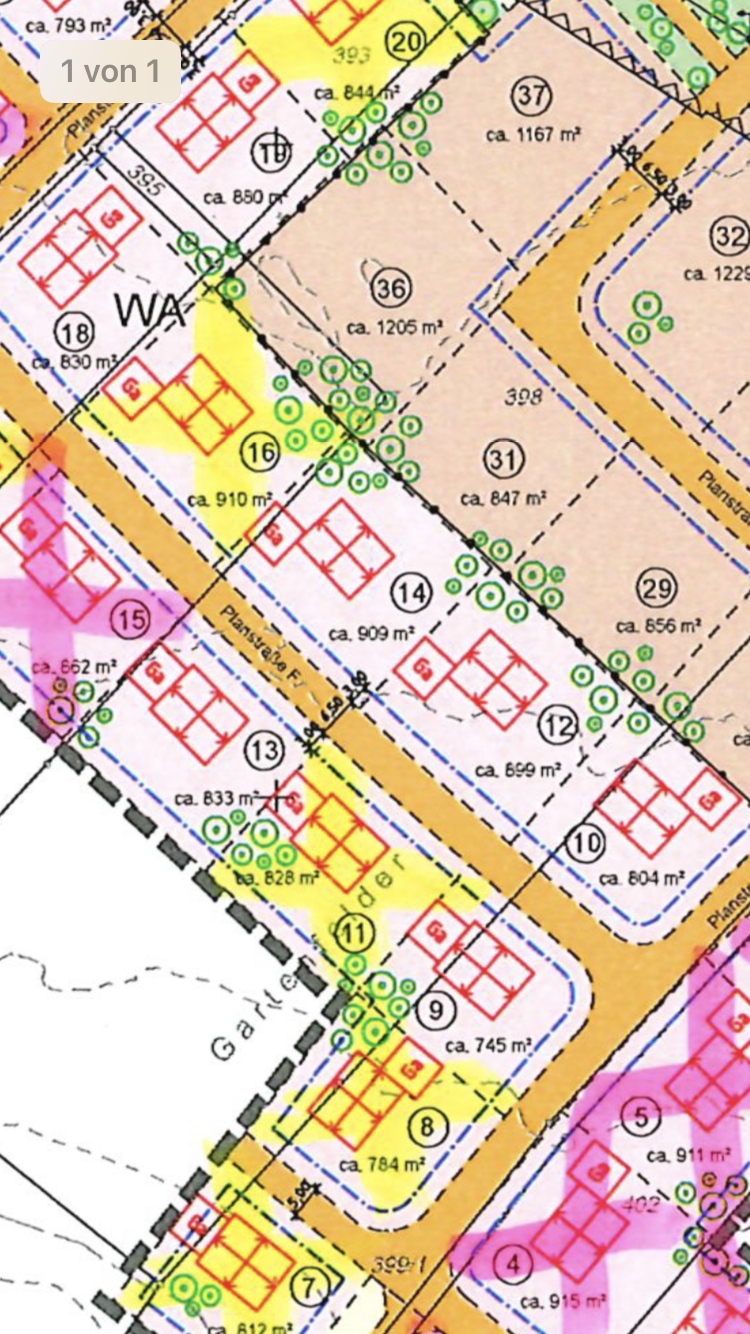

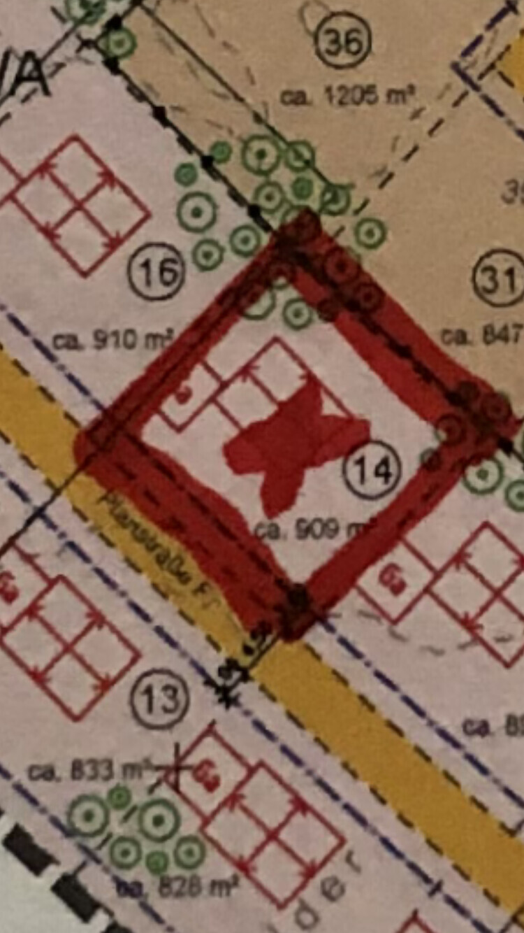

2020-11-03 06:51:24
  • #6
Better? It concerns parcel no. 14
