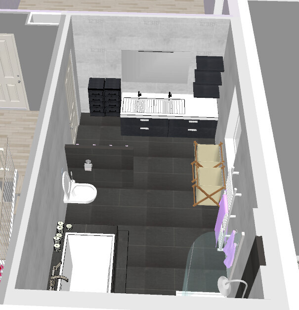

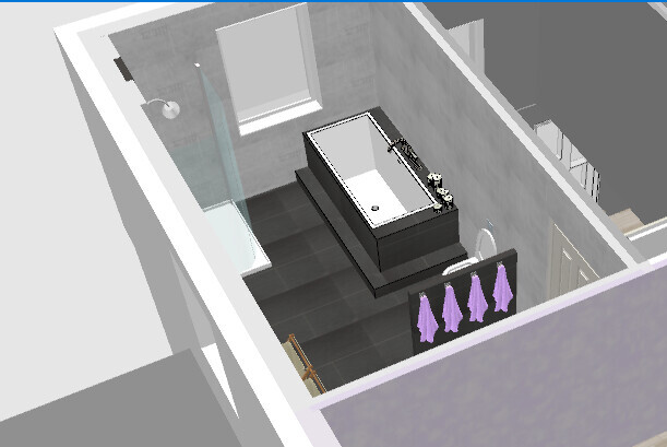

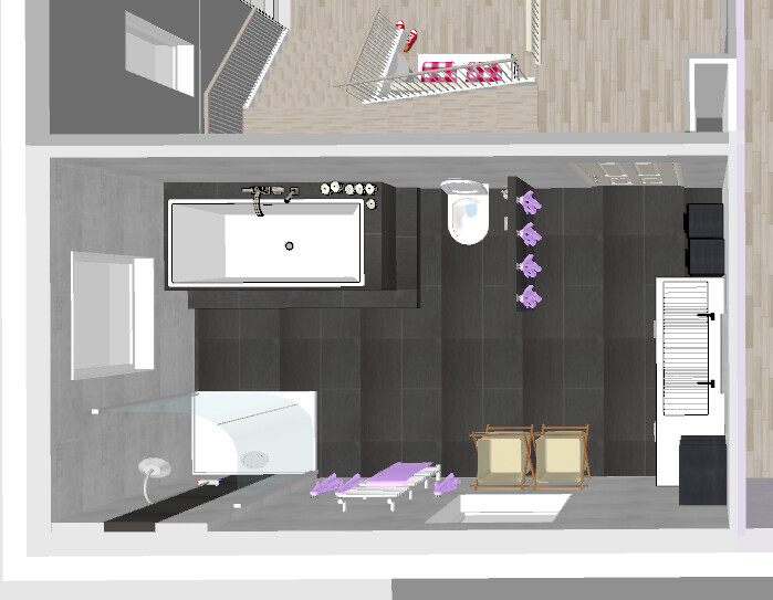

I am working on designing the bathroom and somehow I can't come up with a brilliant idea. Originally, I thought of a T-solution, but I didn't manage to make it fit properly and I had the feeling that it wouldn’t work well with the lighting either. So now I came up with a different suggestion. I planned the front wall to be 1.10 m. I thought of a privacy screen, but I'm not so sure if it will really work the way I imagine it ;)
What is important to us is a shower of 80x120 cm and a double washbasin, as well as an electric towel heater. The bathtub can be for one person. Maybe it would be nice if it were tiled on the outside.
We want tiles in anthracite gray and white (maybe slightly beige tinted).
Do you possibly have a brilliant idea on how to arrange the various sanitary facilities, etc.?
The bathroom is 5 m x 2.82 m. Please don’t be surprised about the square meters. The image comes from my planning and didn’t fully match the dimensions on the upper floor in Sweet Home 3D.

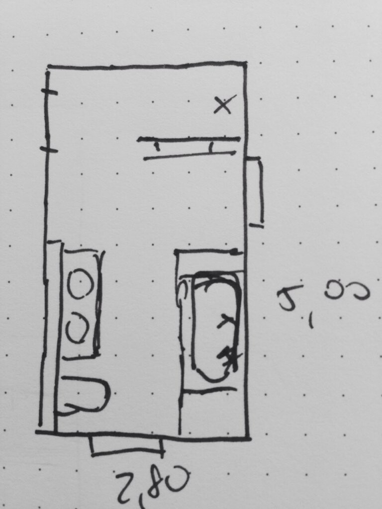

2017-07-20 15:17:05
  • #3
Spontaneously drawn:

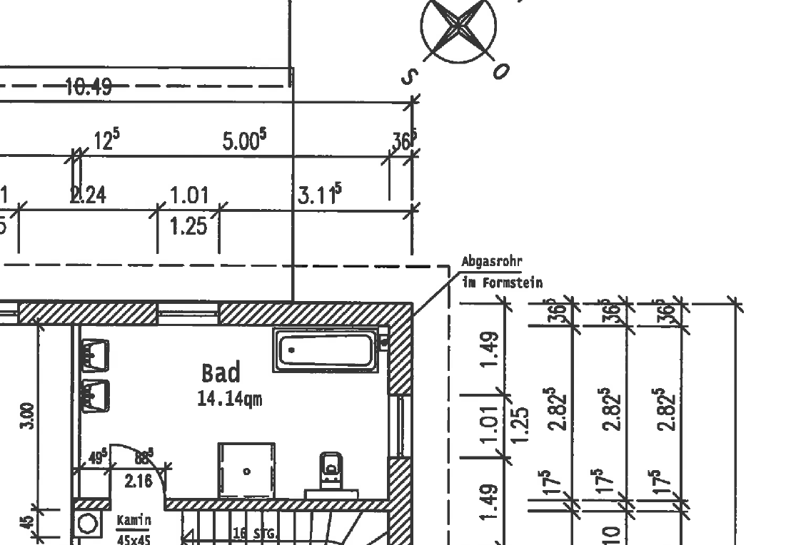

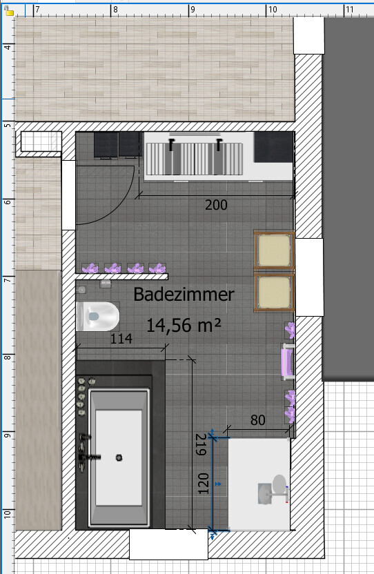

So here quickly the more precise data. I immediately notice that I have overlooked an exhaust pipe
Eldea
2017-07-20 18:57:09
  • #6
Ok, I guess I'll try that again [emoji85][emoji6]
