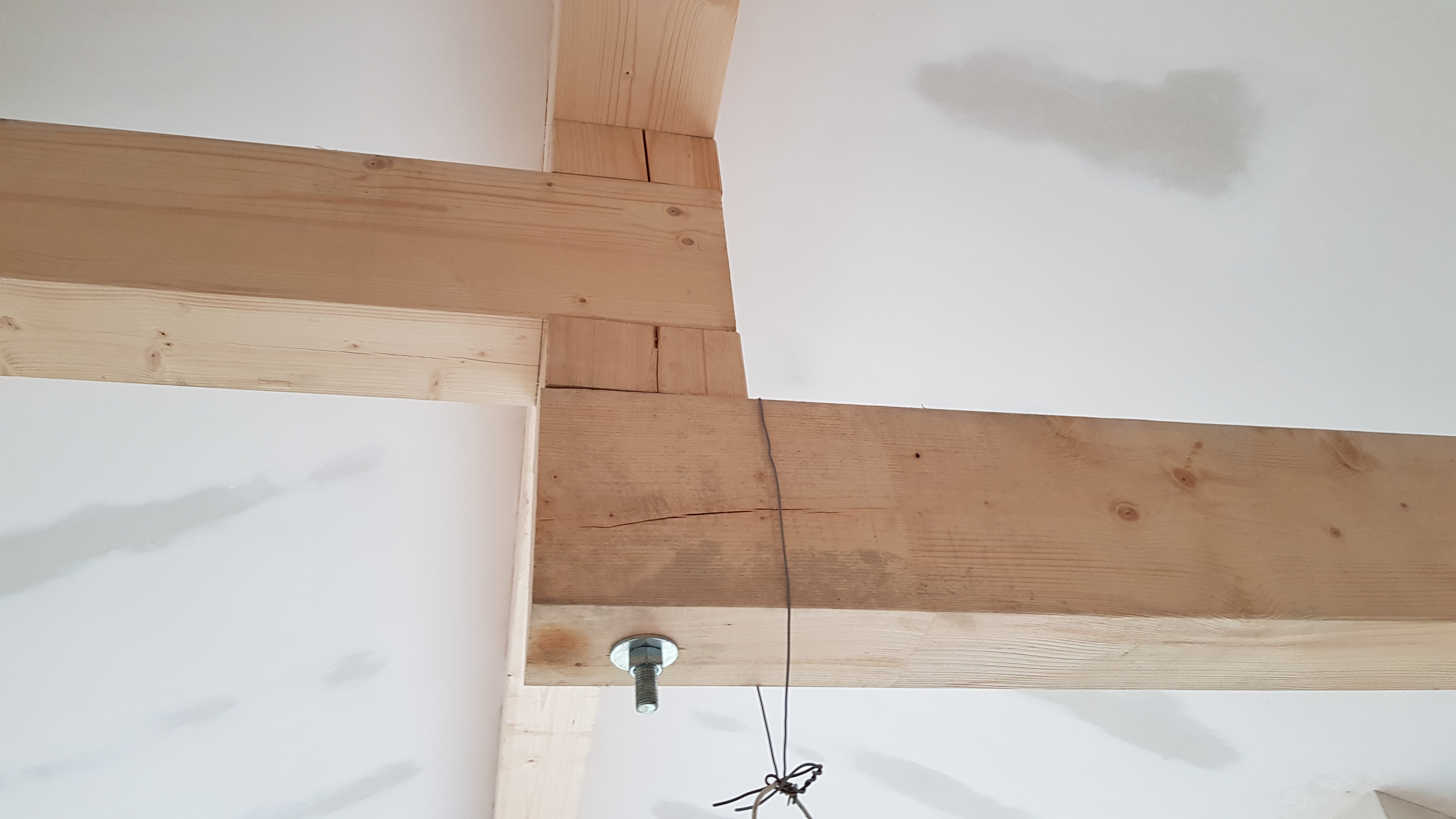

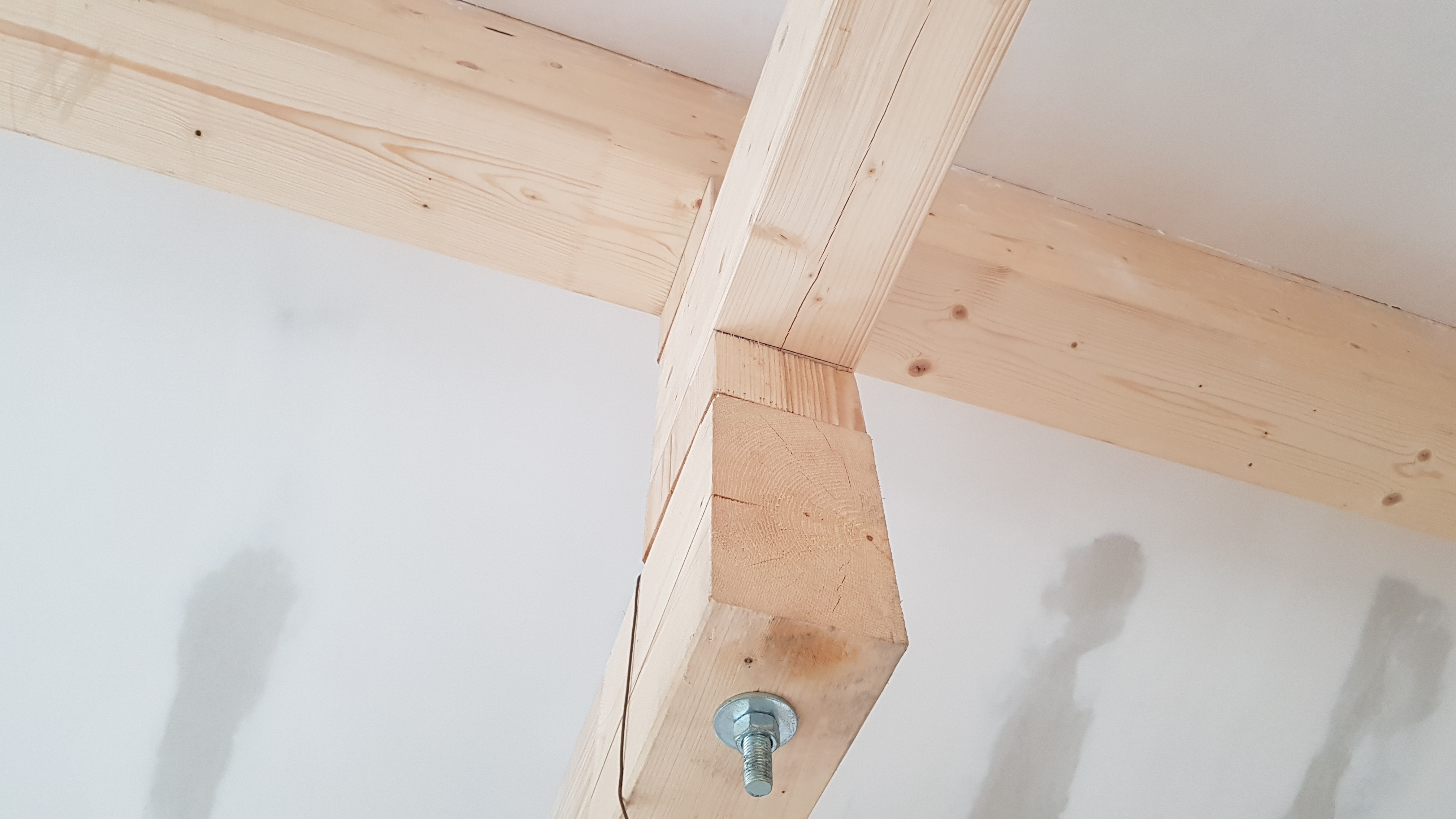

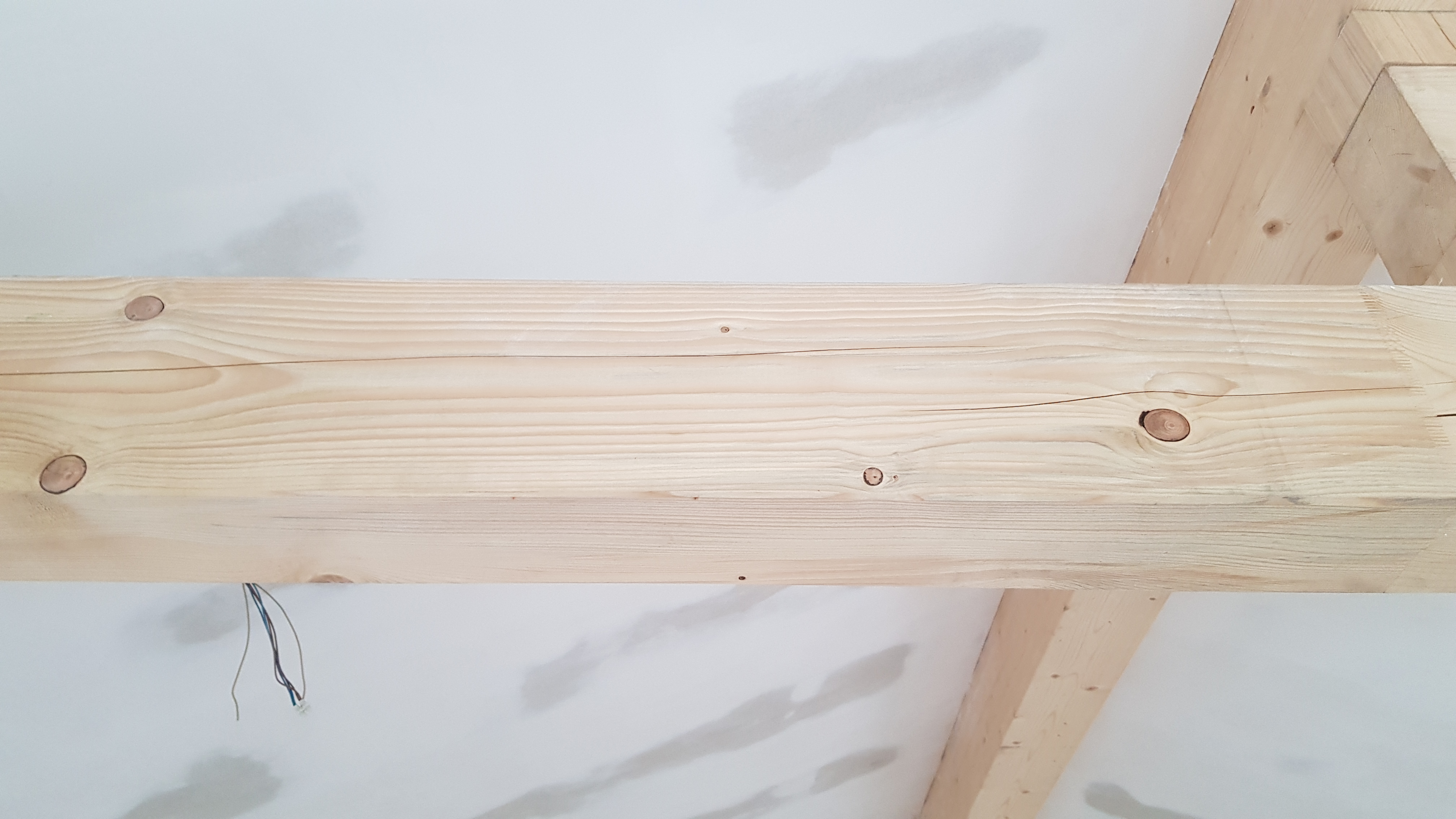

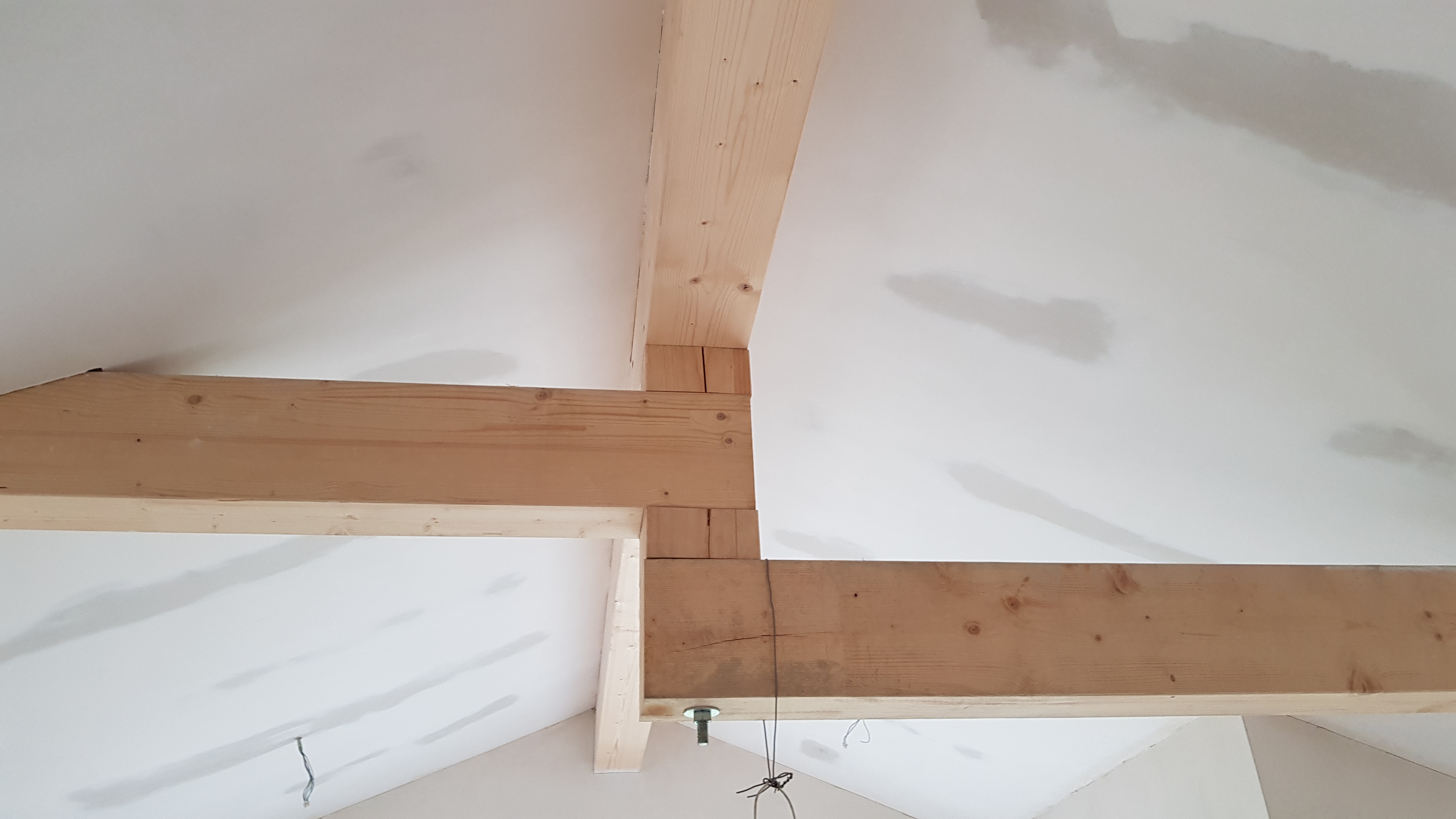

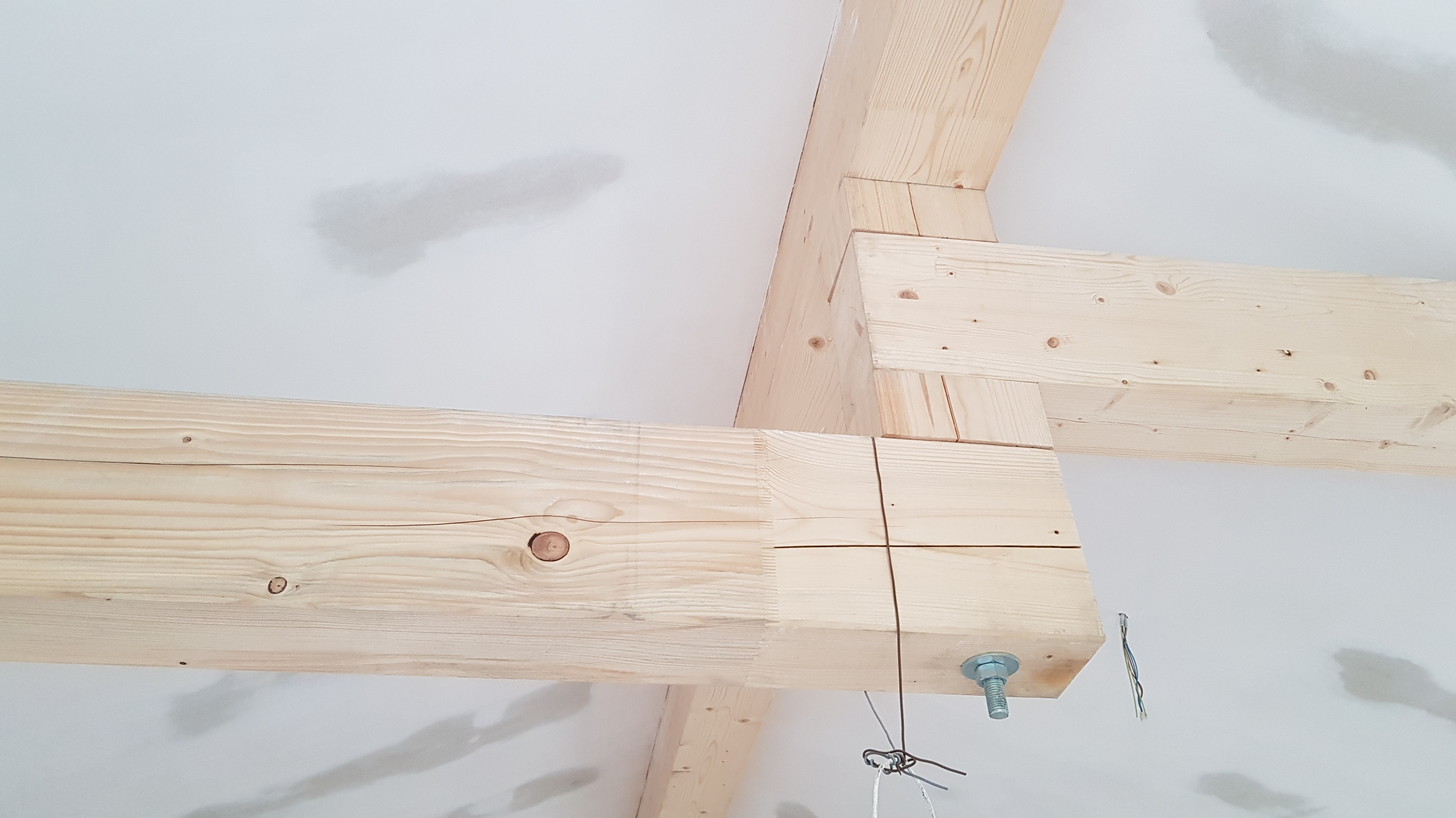

Hello everyone,
in my house, which is currently under construction, you can see small cracks on the roof beams.
I have attached photos of them.
Are these cracks serious, and should something be done about them? Or is this rather harmless and normal?
Regards
Jens

PS: Solid wood always has a few cracks. There are design tables for this in timber construction. Your little crack is miles away from critical
