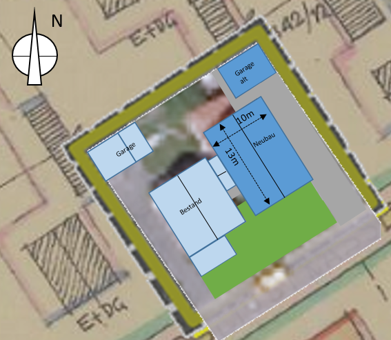

Development plan/restrictions
Size of the plot ~ 400m²
Slope -
Floor area ratio 0.4
Floor space index 0.8
Building envelope 10m x 13m, see attachment (shown in dark blue)
Edge development: direct extension to existing building
Number of parking spaces: 2
Number of floors: 3 floors -> basement, ground floor, upper floor with 1.5m knee wall inside (+ open attic)
Roof shape: gable roof
Style: settler house / passive house in timber frame construction
Orientation: see picture
Maximum heights/limits: 9.2m ridge height, 4.8m eaves height, 1.5m knee wall inside

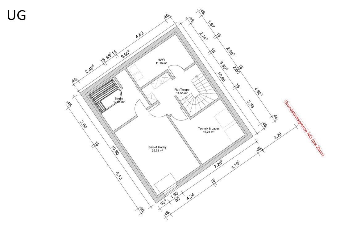

What do you not like? Why?
Position of home office not yet 100% clear if it works in the attic. Basement as an alternative but possibly too dark in the long run despite light well...
Price estimate according to architect/planner: -
Personal price limit for the house, incl. equipment: -
Preferred heating technology: groundwater heat pump and underfloor heating

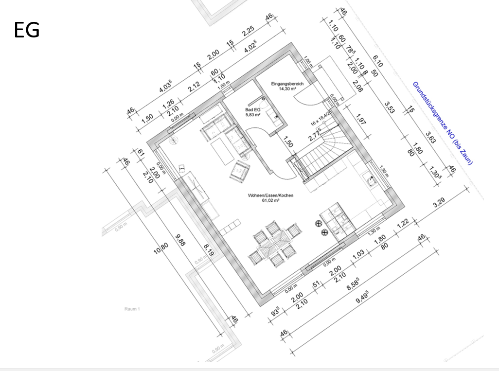

Open issues are:

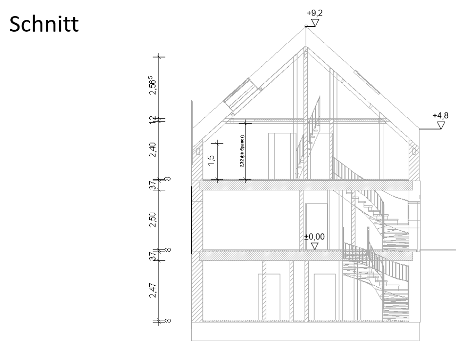

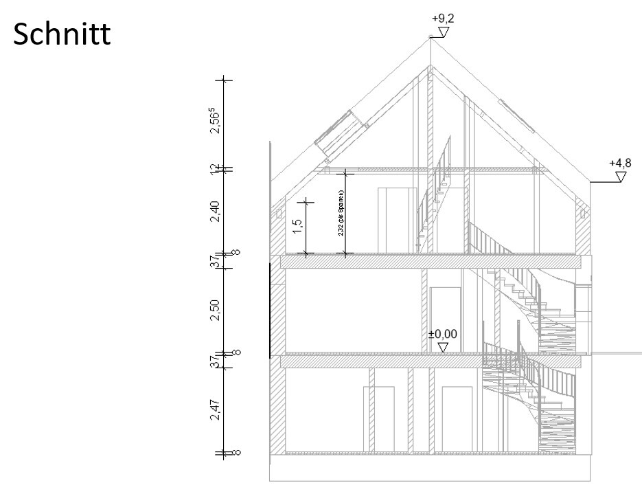

- Floor heights / ceiling thicknesses / general floor buildup
- How far back should the house go (for daylight incidence through SW living room windows)
- Fixed / movable partition wall dining room to living room?
- Execution of basement light well
- Execution of gallery ceiling / gallery room height
- Size of children's rooms sufficient?
- Windows: generally check window sizes

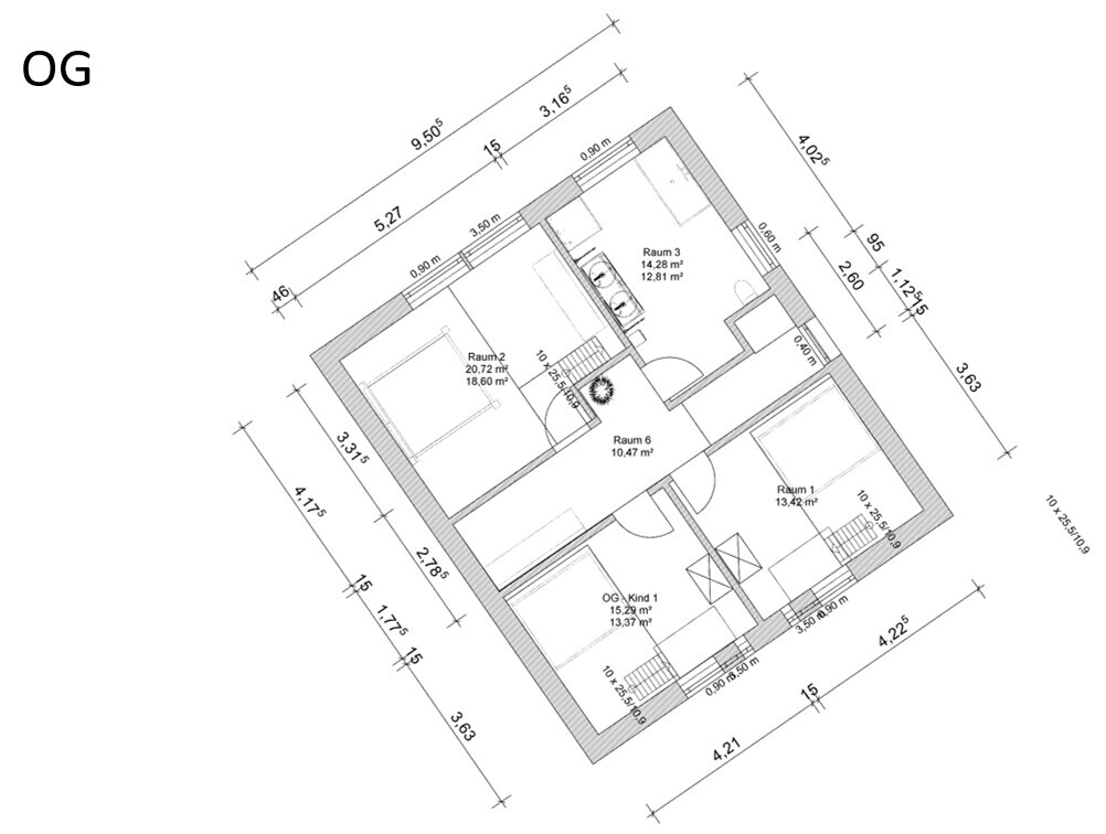

Upper floor:
- Roof windows in children's rooms & bedroom: how to clean?
- Roof window bathroom?
- Roof window upstairs hallway? Where (consider extension) and how to clean?
- Where to place windows for stairwell?
Ground floor:
- Size of both living room windows

  • #2
I personally find EG and OG stylish. The only thing is that the hallway in the OG between the children's rooms would be wasted space for me. It could be divided between the child and room2. However, the stairs into the children's rooms probably won't work like that without ducking, even though I think the idea is pretty cool :)

  • #3
For the ceiling on the upper floor, 12cm will probably not be enough. Mine, for example, are 18cm thick with similar house dimensions. In addition, there are 2.5cm battens (possibly counter battens +2.5cm) + 1.2cm drywall + covering (for us 1.5cm + 2.2cm ESP + 1.0cm laminate) in the attic. Better plan for 25cm there. You don’t want to run out of ceiling height.

Before questions arise again: where is the street? Directions? And: what is the budget? Have you already added up the living square meters (i.e., every room within the thermal envelope)

Sorry, but nowhere is an orientation indicated.
If the blue text with NO actually means northeast, then the entrance is also NE, ok, the long driveway SE. Yes, that makes sense.
